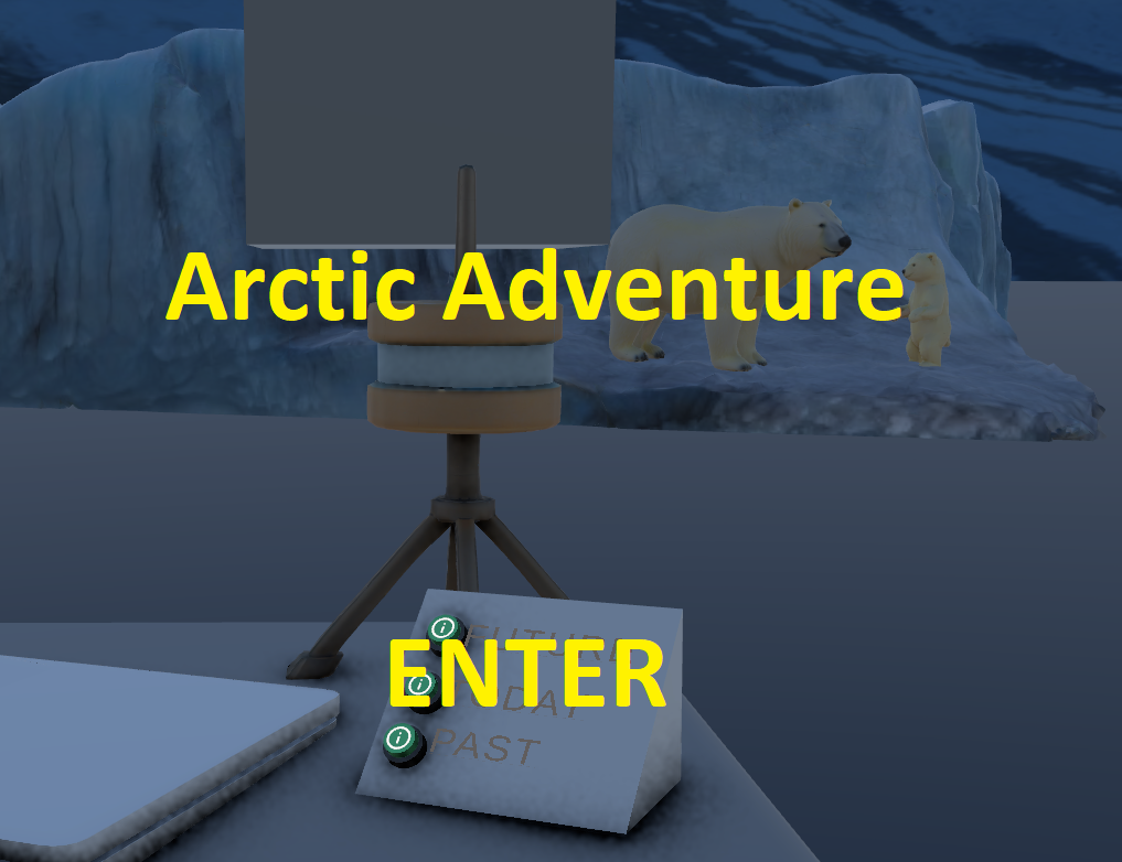

    Guys, why weren’t you at the bi-weekly meeting last week? I did a full description of the process there. What I recommend you do is to keep your special project on your server entirely and create a small mini-project in the World Builder from which you launch your installer vrml-file.
    • In the mini WB project, you have just an image which is a snapshot from your app and maybe a text like “Please Enter here”.ice
    • Surround the image with a trigger box. Activate the trigger for “body enters trigger box”
    • In the Logic Editor, drag the trigger in as a callback node and attach it to a Change Location node. Set that node to change to an external location and enter the HTML-Link to your installer-vrml file
    Use the publishing mechanism of the World Builder to publish this in the Shop. Make sure the link to your installation vrml-file is stable.
    That’s it. 🙂
    Of course you can also double-click on the vrml-file you downloaded from the shop to automatically launch the Hopper who in turn will automatically run your installer/launch-vrml as soon as the avatar enters the trigger zone. Hope this helps.
