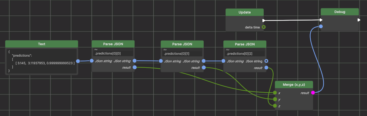

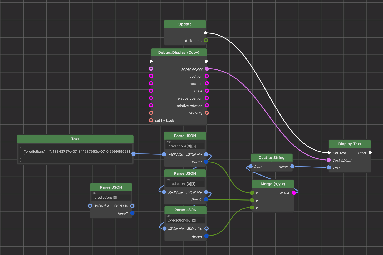

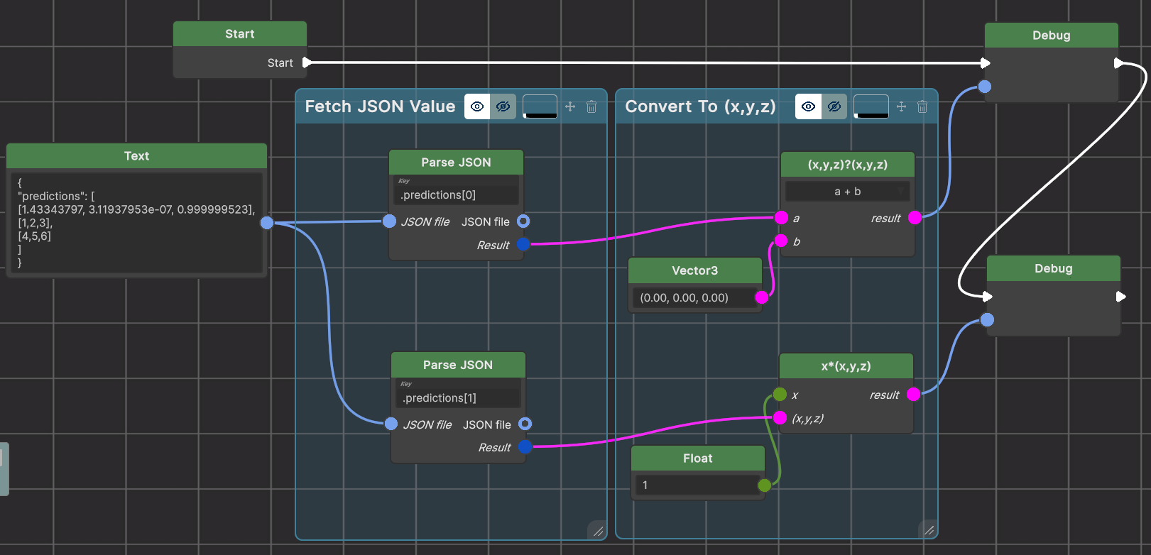

February 24, 2025 at 3:28 pm #819OK, what you need to do is this:
Notice that the predictions have a ‘.’ (period) in front and you can only select one value at a time.
However, the Merge Node currently does not support strings as inputs (only floats). This will be fixed in the next update. Sorry! But the next update (0.2.1) is not far away…

February 25, 2025 at 9:15 am #822I see that what you are trying to do is very common. So I expanded the Parse JSON Node to make life easier for you.
I suppose, this is more to your liking? 😉
The outputs return “”, 0.0, (0.0,0.0), etc. if the JSON is not structured in the expected way.
Next release…

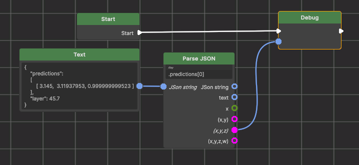

February 26, 2025 at 2:04 pm #836This will probably be the final version (0.2.1):
The “Result” output of the Parse JSON Value node can be any number of value types. The type is determined by the input type of the node it is connected to. By connecting the Result to a node with an (x,y,z) type of input, the Result is converted to this type and comes out as (1.43,0,1). If you were to directly connect the Result to the Debug node, the Result would produce a text
   1.43343797,
   3.11937953e-07,
   0.999999523
]because the Debug input type is text. In this demo the Parse JSON nodes are connected to identity operations (+0 or *1) to force the Result to be of the required (x,y,z) type, but in practice you will probably connect the Result output to something that works with the correct type which you want to operate with and thus needs no forced conversion.

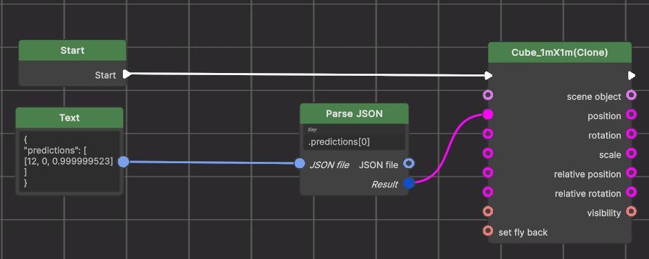

March 20, 2025 at 11:34 am #1361As a matter of fact “.predictions[0][0]” really doesn’t work. However, you want to access the Vector3 anyway and that works. See below:
The output of the JSON file can be interpreted as anything, in this case as a Vector3. The cast is implicit because the input of the Cube is a Vector3. You can use an explicit CastVector3 node, but in most cases you won’t need that.
What also works is to have more than 1 vector:
.predictions[1]
.predictions[2]
…Hope this helps!

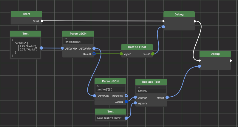

April 2, 2025 at 3:54 pm #1430Good news: adressing .entries[x][y] now works just fine.
This example will debug print first “5.75” and then “New Text: World”. Wait for our next Release!
