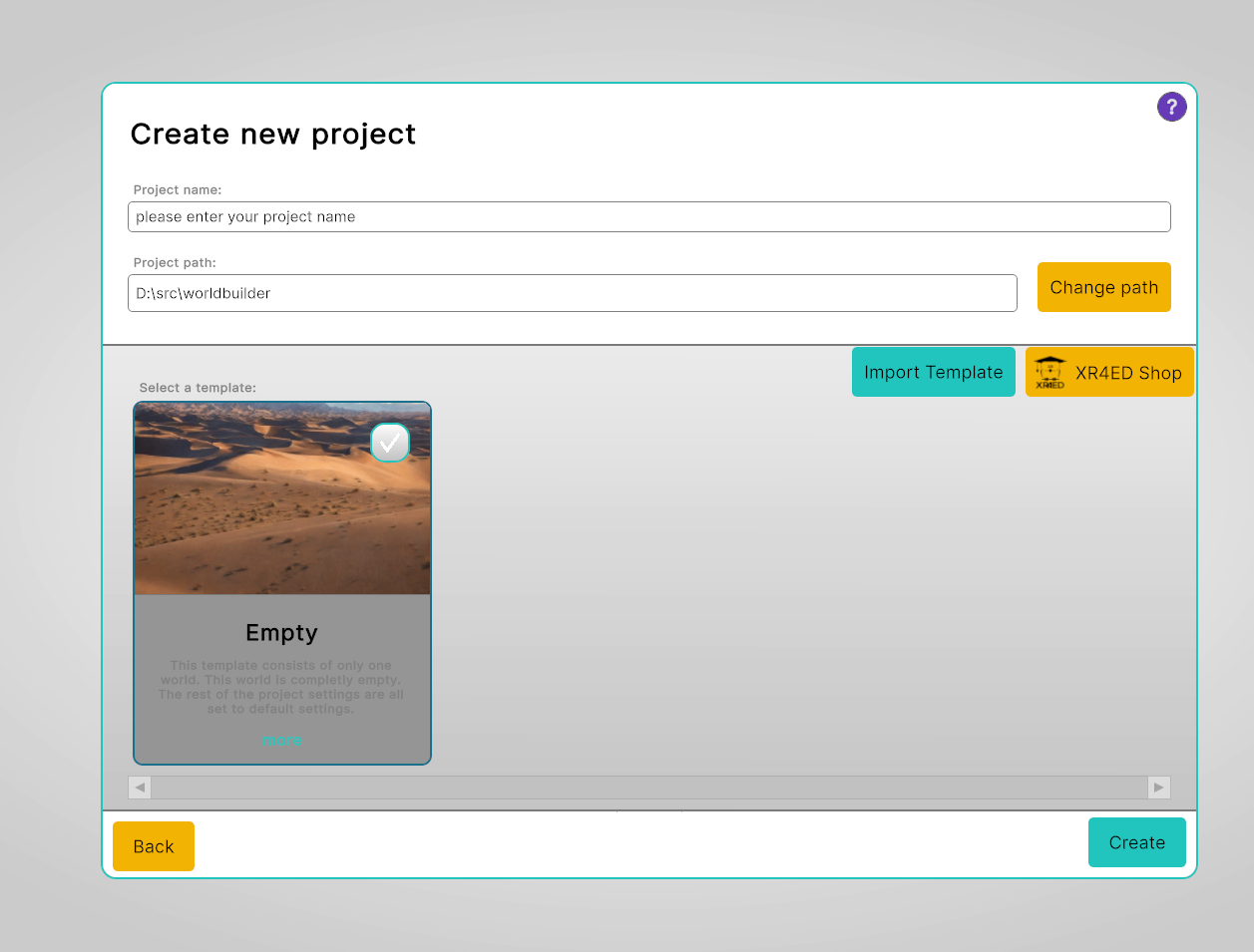

    Then the things that remains – how to get the AR App Wizard?I’ve searched around in the WorldBuilder, but I do not see it anywhere. When creating a new project, I see only this:

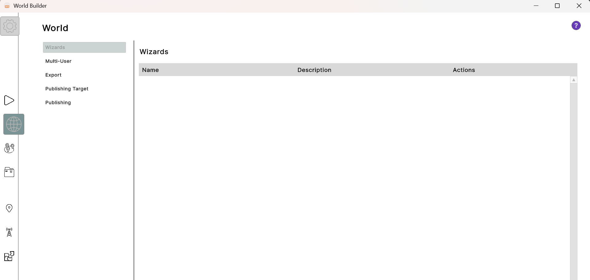

    When I make a project, and look in the World/Wizards section, this is also empty:

    You need to “buy” it in the XR4ED store (put in cart and check out). Then it will download and install automatically the next time you start the World Builder.

    I believe there is a misunderstanding here. The template that includes the wizard is specifically intended for configuring the CYENS AR app and is most likely not compatible with other applications. If you are developing your own Android/iOS app and need a configuration tool to create custom content, a similar wizard should be developed. If that’s not the case, a different form of integration with the XR4ED platform would be required. This means the app should use the REST API, and more specific details should be discussed with the your mentor.
    This forum is intended for questions regarding the World Builder and Portal Hopper. For questions on how to create a wizard plugin, please refer to the following links:
    https://www.portalsunited.com/docs/world-builder-how-to-create-a-plugin/
    https://www.portalsunited.com/docs/world-builder-what-is-a-wizard/
    If there are further questions about the World Builder or the Portal Hopper, these can be addressed during the bi-weekly help sessions or in this forum.
