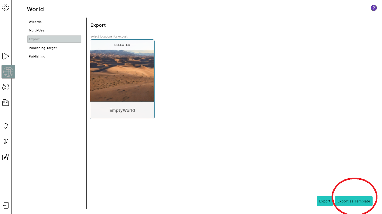

Or we need to change our project and adapt.March 19, 2025 at 3:15 pm #1341I found your template and it turns out, it was not published as a template. It looks like you uploaded a published project. Templates are formatted in a different way. To publish your project as a template, please
use the marked button “Export as Template”. This will create a template file and upload it to the shop.
