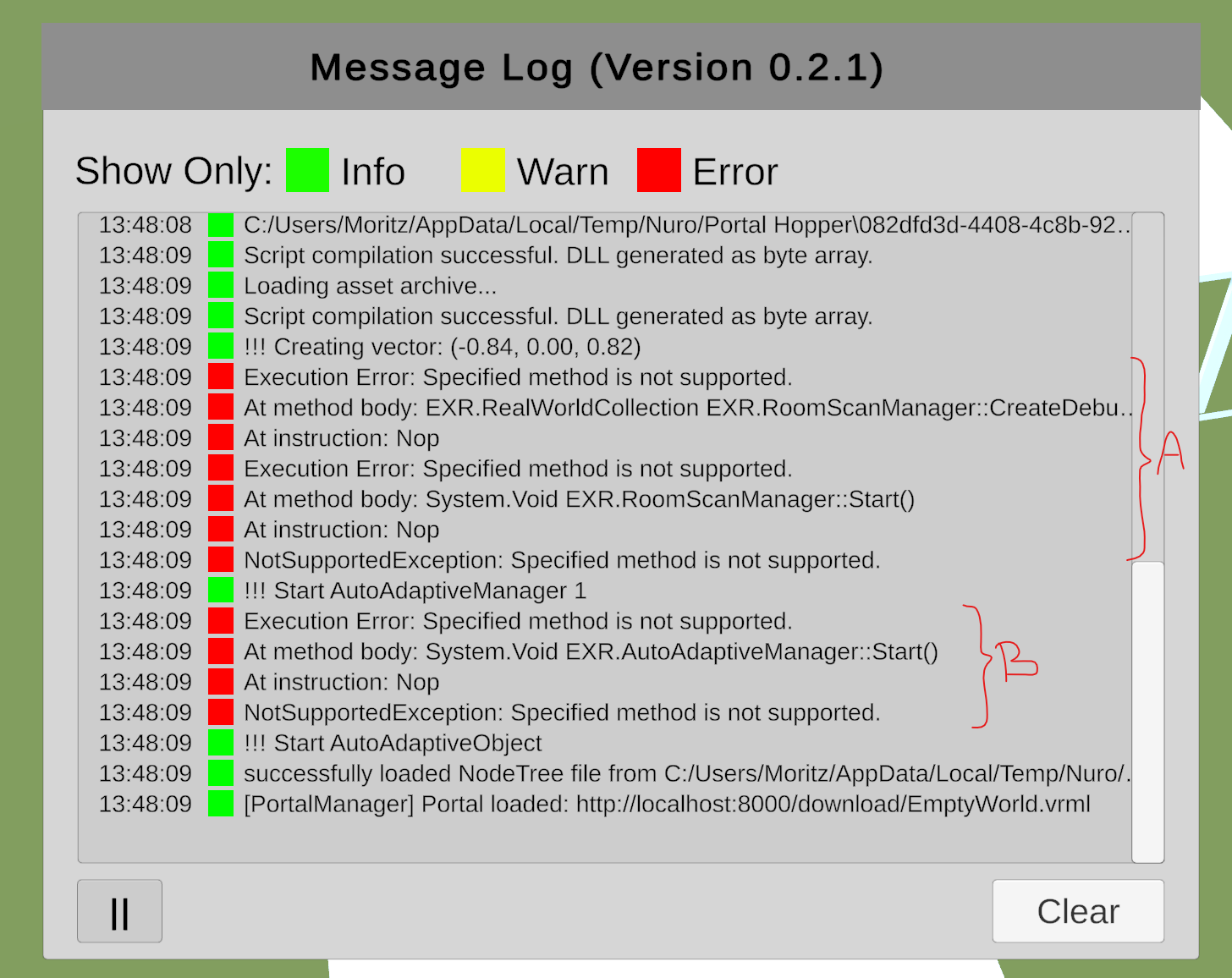

I get several time the following error:
Execution Error: Specified method is not supported
A: here I am trying to call:
var o = JsonConvert.DeserializeObject(myCustomClassString);
with using Vector3 instead of MyCustomClass it works.
B: here I am trying to find all objects of type MyCustomClass : DataComponentBase. Both versions doesn’t work:
_autoAdaptiveObjects = FindObjectsOfType(true);
_autoAdaptiveObjects = FindObjectsByType(FindObjectsInactive.Include, FindObjectsSortMode.None);
with using Transform instead of MyCustomClass it works.
Any idea how to solve this issue?
try this, call
var components = FindObjectsOfType<DataComponentBase();
and then foreach
if (component is MyCustomClass)
//do something with it
That might work.
